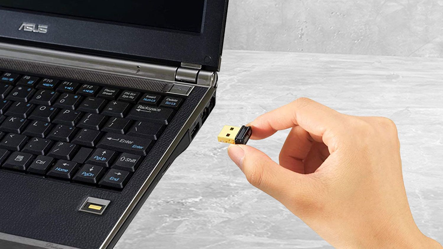

Asus од Сетек (1000 денари):
USB-BT500|Wireless Adapters|ASUS Global
www.asus.com
Asus USB-BT500 Bluetooth 5.0 Adapter Review – Gaming Guide
The name Bluetooth comes from the epithet of the 10th-century king Harald Bluetooth who united the Danish tribes into a kingdom. As a technology, we use Bluetooth to connected devices to each other. It is preferred over the much faster Wi-Fi for connections that do not require transfer of large...gaminguide.com
The best Bluetooth USB adapters for PC
The best Bluetooth USB adapters to upgrade your connectivitywww.laptopmag.com
Некако за Асусов има повеќе информации на нет, ама и поскап е 2.5 пати...
